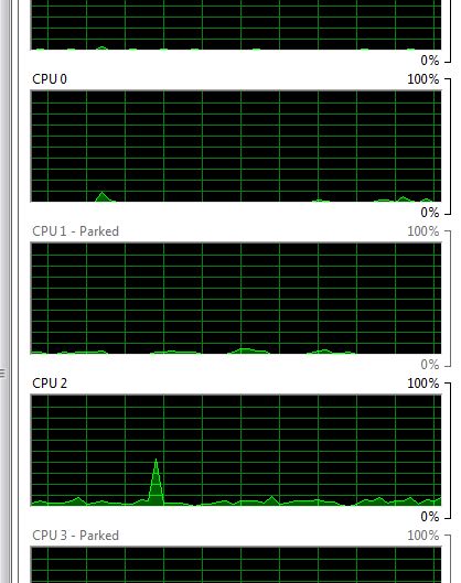

montcer9012 instead of setting it through k10stat have you tried windows power management under
Control Panel -> Power Options -> Change advanced power settings -> Processor power management and set the Minimum processor state, set to 100%
You might want to look into disabling 'core parking' too (search google for more info), windows (7-8) will park cores to save a tiny amount of power and force most of the load onto the first core until there is enough demand to unpark the other cores (you cpu has to support core parking, if it does windows enables it automatically, also I'm not sure if amd processors have this.)
Quick way to check is under task manager -> performance click Resource monitor -Click CPU look on the right side of the screen for Parked next to the core name
[attachment=10034] < Parked - Unparked> [attachment=10035]
(10-11-2012, 11:29 PM)hyakki Wrote: [ -> ]montcer9012 instead of setting it through k10stat have you tried windows power management under
Thanks for the suggestion, but my AMD is a rebel and he does not do what Windows told; even i set the PowerPlan on High Performance taking care CPU is on 100% usage like you say, CPU stay on 800~1800MHz. So, to be sure he works at top i use Catalyst Control Center to set it but CCC only let me force the maximum at 1800 MHz; the 2.5 GHz boost activate automatically.
About the parking thing, mine CPU does not do that or is not activated.
And about your test resuly, is huge different from mine hahahahaha. What model is your CPU?
